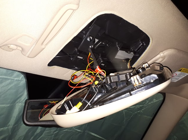

how to remove the plastic cover (where the high beam sensor is inside) in front of the inner mirror?
I have a bad noise coming out of it and once removed the roof light. but I was not sure to put off this cover without removing the roof interior.

it's just clipped pull on it.

I'm not sure I have answered the question but in principle everything about this car is clipped.

:thumbsup: or glued.... :D
